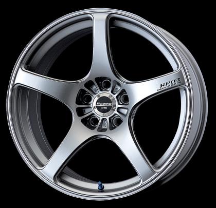

I ended up going with 18x8 w/ a 40 offset and got the 'full' look I was trying to achieve. My previous wheels were 18x7.5 w/ 40 offset; I didn't realize that the .5 would appear to make a difference.
I ended up installing a set of the Enkei RPO3's with a set of Toyo TR1's - 225x40 18. The clearance was fine.
Not sure how to post pics so this is a second attempt...
